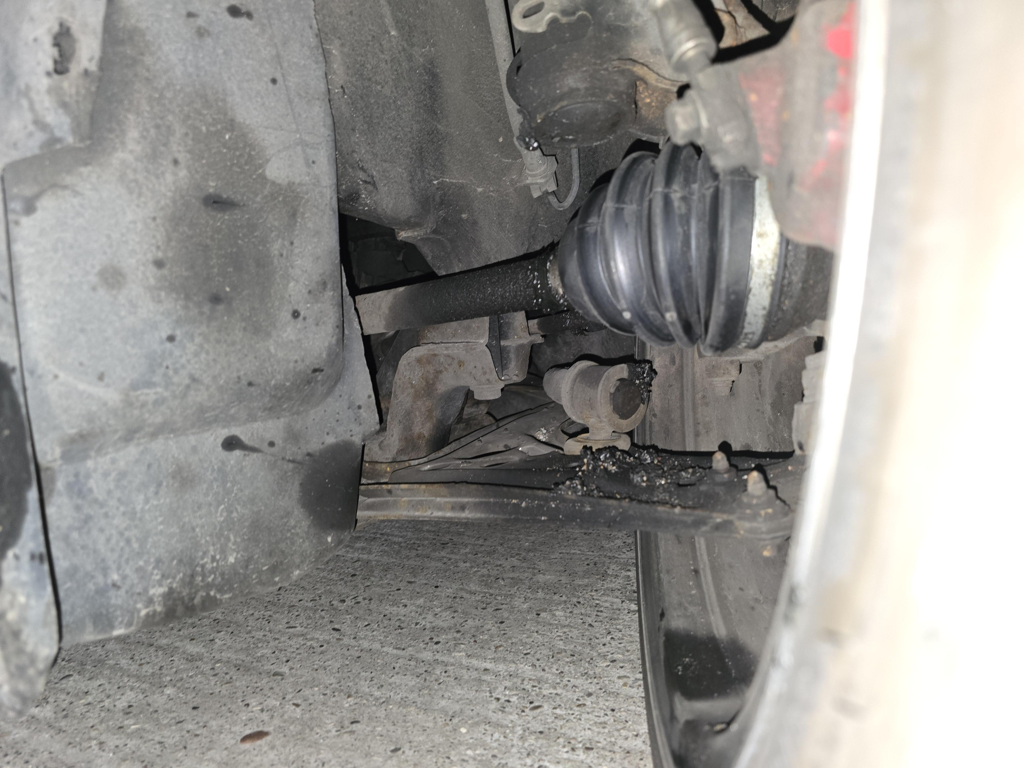

Hi, so last summer my drive shaft dust boot was leaking and it caused me to fail TÜV (German MOT) so I had that fixed.
Well today I checked behind the wheel again and this is what I see
Im gonna assume the Garage that "fixed" this for me just cleaned it up so that it wouldn't be noticed at the TÜV, since he didn't write anything about Driveshaft in the invoice, which I noticed today also.
Im also pretty sure he fitted the wrong dampers in the rear, standard lupo ones, as the car barely even dampens in the rear now.

It's always the left side that fails... I have the same on one of mine. I will swap the boot when the weather is nicer...
