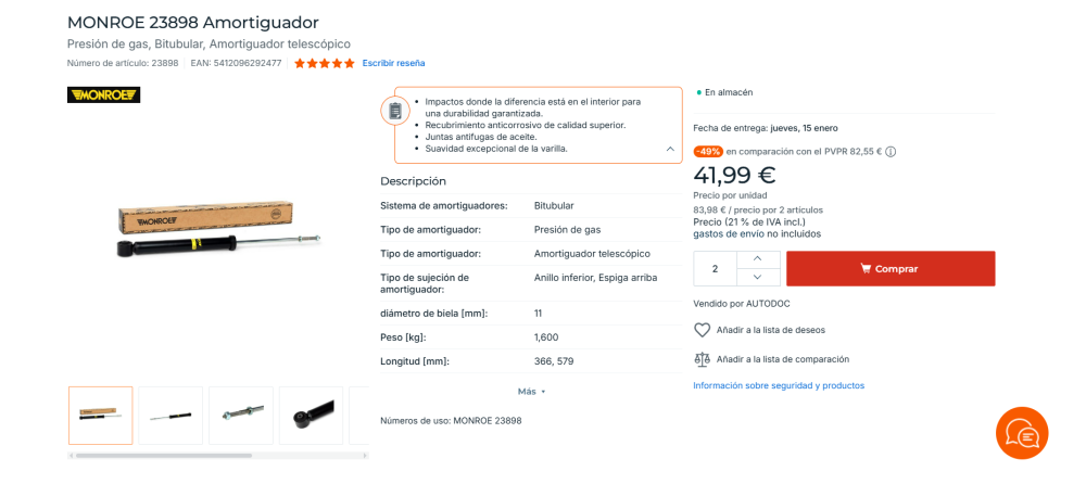

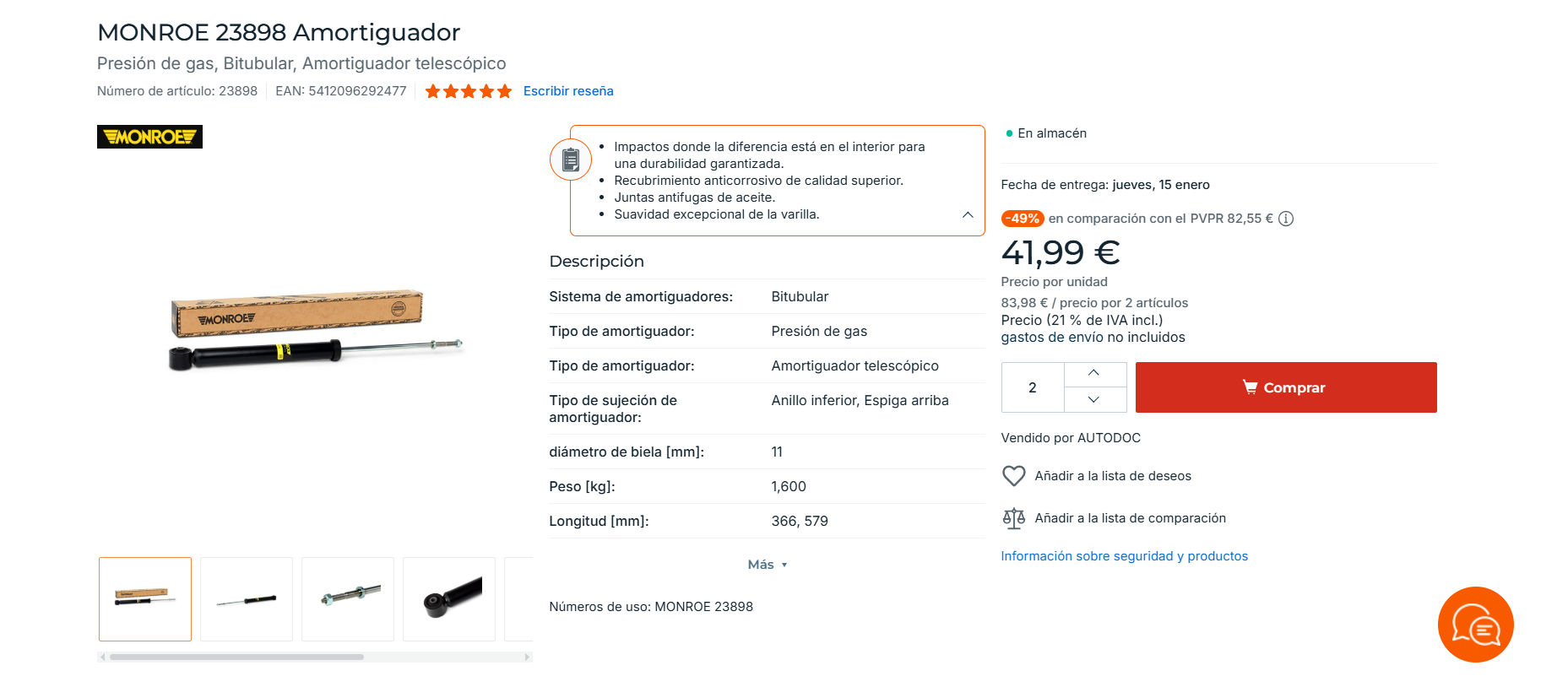

Some months ago, I changed the two rear shock absorver/dampers of my 1999 VW Lupo. I took aout the ones that comes from the beggining and I put two Monroe ones. I heard that they are good and bought the one with the OE number  OE 6X0513025B — VW / SEAT. My problem is that since I changed them I feel that the rear suspension is very hard,  the back of the car jumps in each pothole if I dont go 20 km/hour, anyone knows if this is normal or what? In the technical revision they gave me the okay but I feel that is shouldnt be like this.
I put here the link to the dampers: https://www.autodoc.es/monroe/7435660
