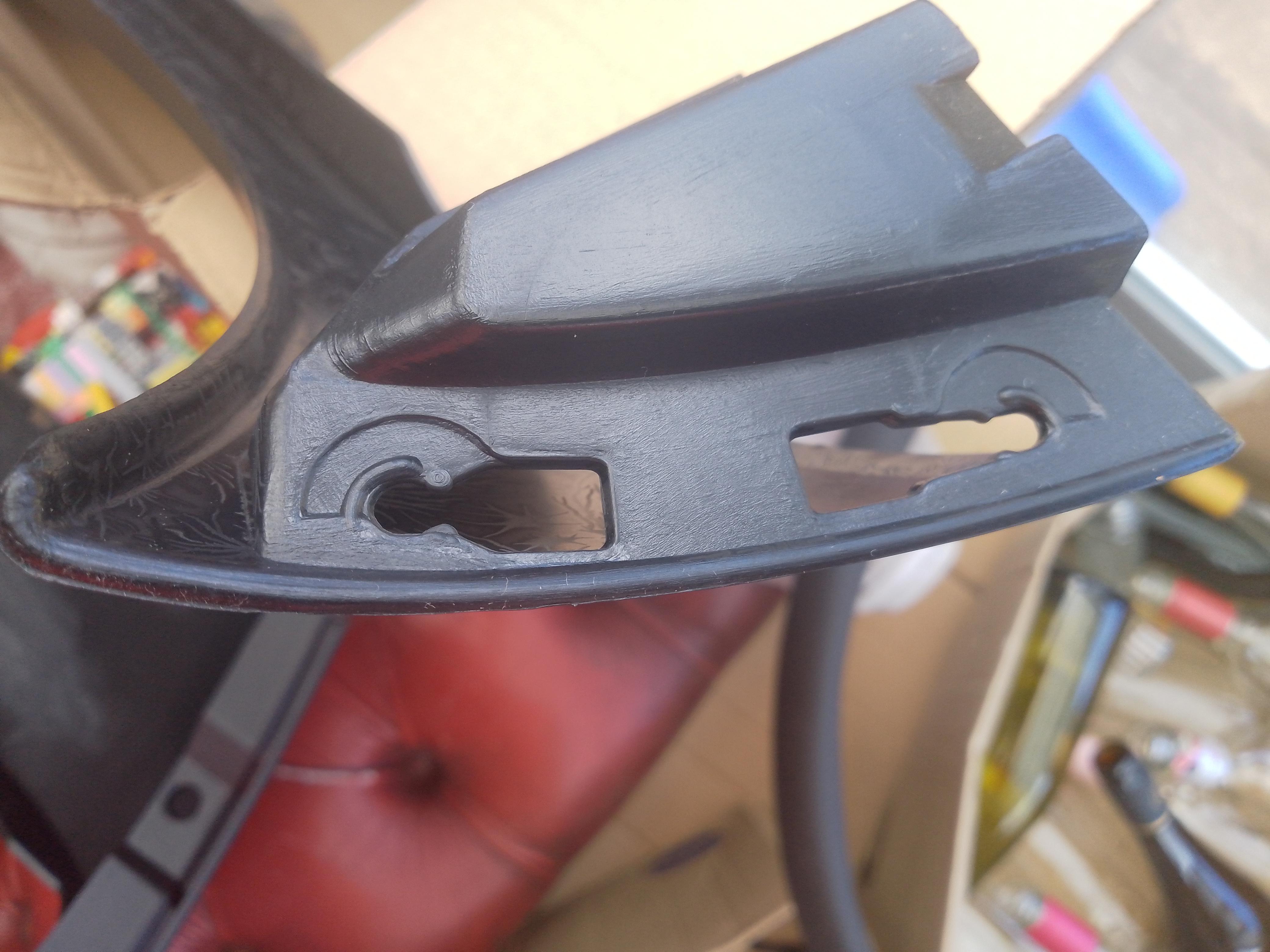

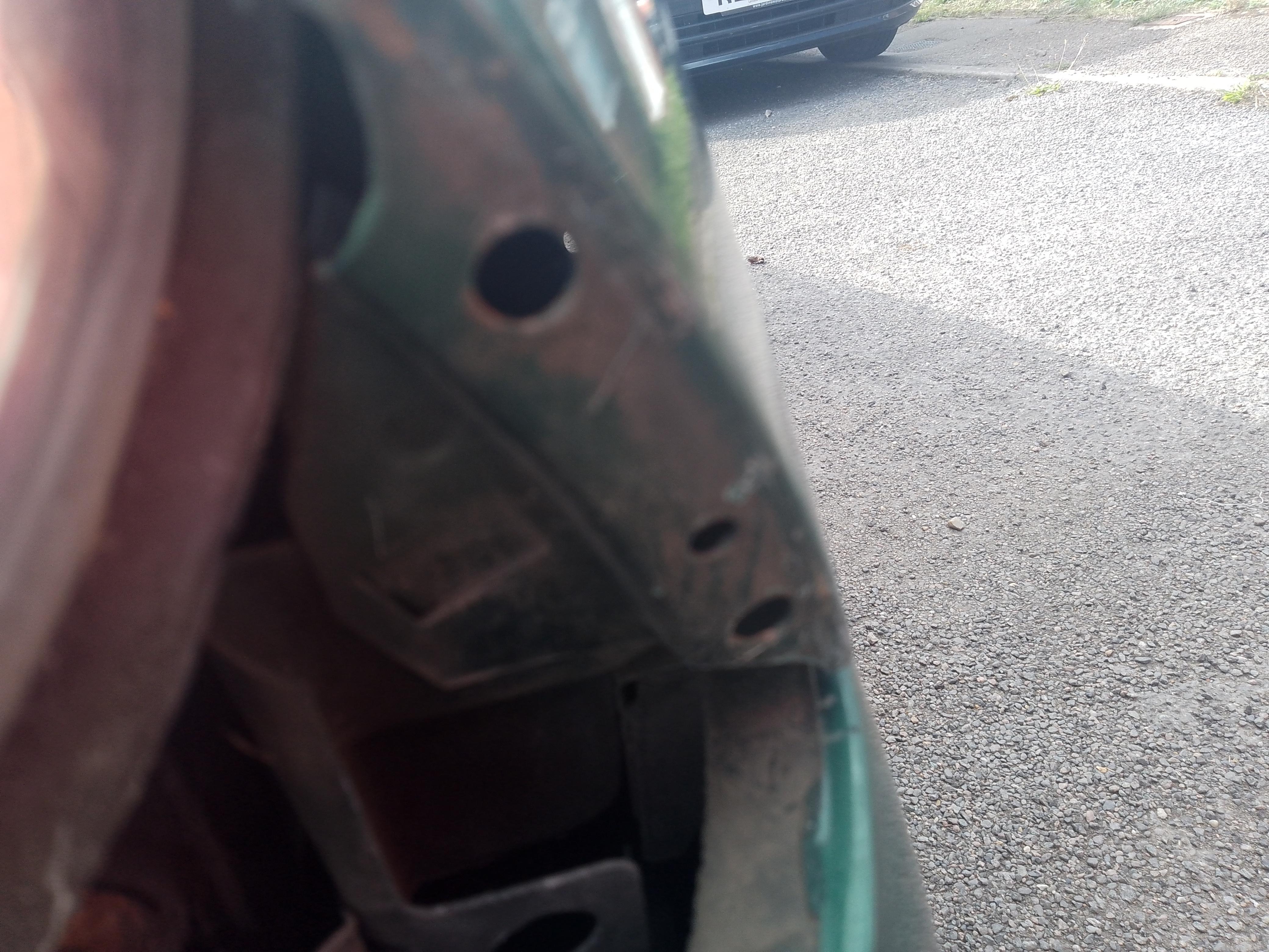

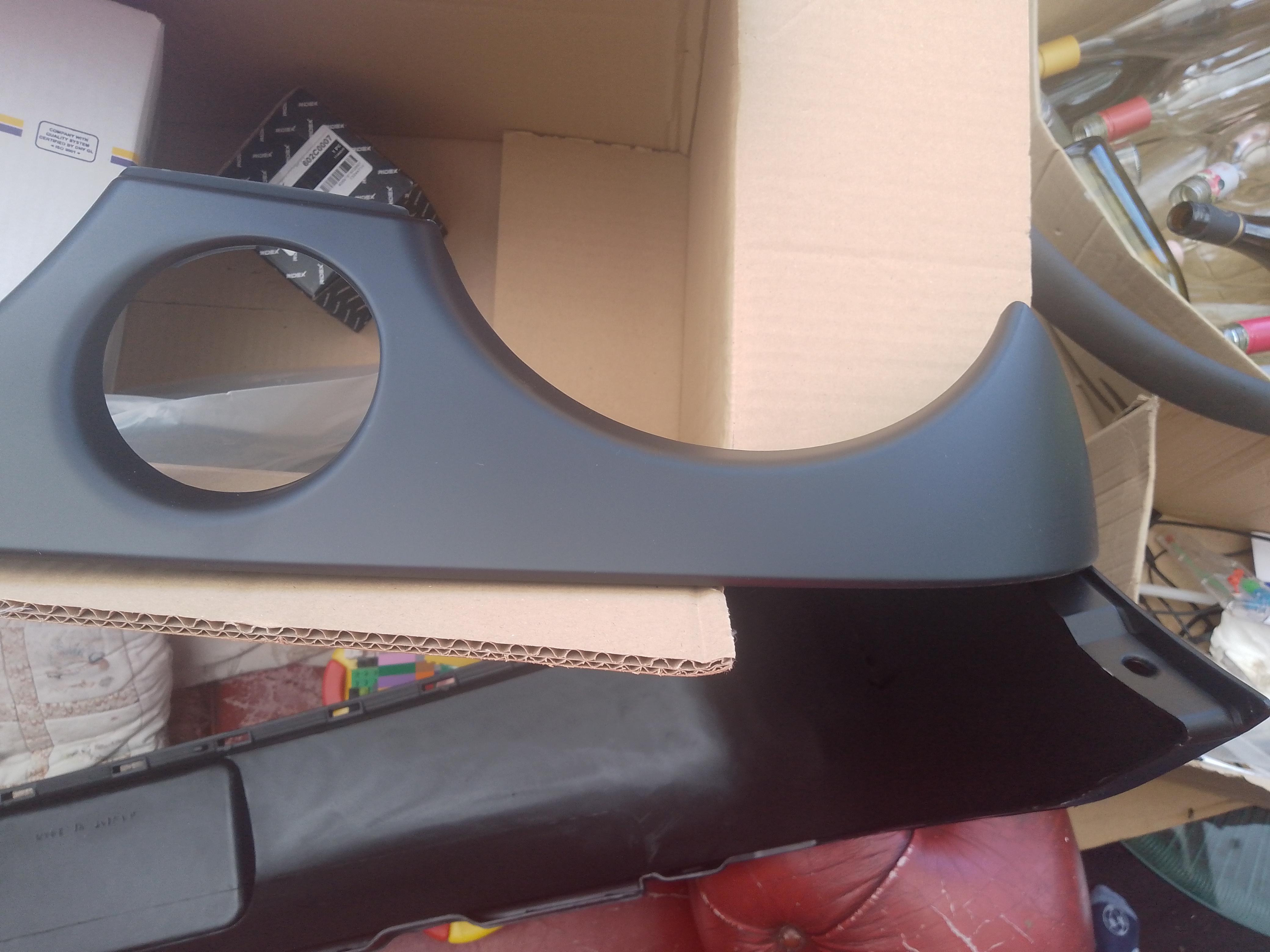

IMG_20250921_140059.thumb.jpg.595eee13c1a156031cee3786fe151b96.jpgTo anyone who can help me
Hi there I'm asking for help on buying mounting clips for the panel that clips into the wing ?
Also do you clip the panel strip with indicators on the new bumper or after when it's fitted to the car   ?

It’s tricky to remove this front panel without damaging anything, but once it’s off, I’ve never had any problems pushing it back on. Put everything in place, except the front grill, turn signal lights bolted on, then install this piece by pressing the clips into the wings, and finally install the rest and front grille. I’ve done it at least five times, and I haven’t noticed any problems with this design, except for the removal part.🙂
