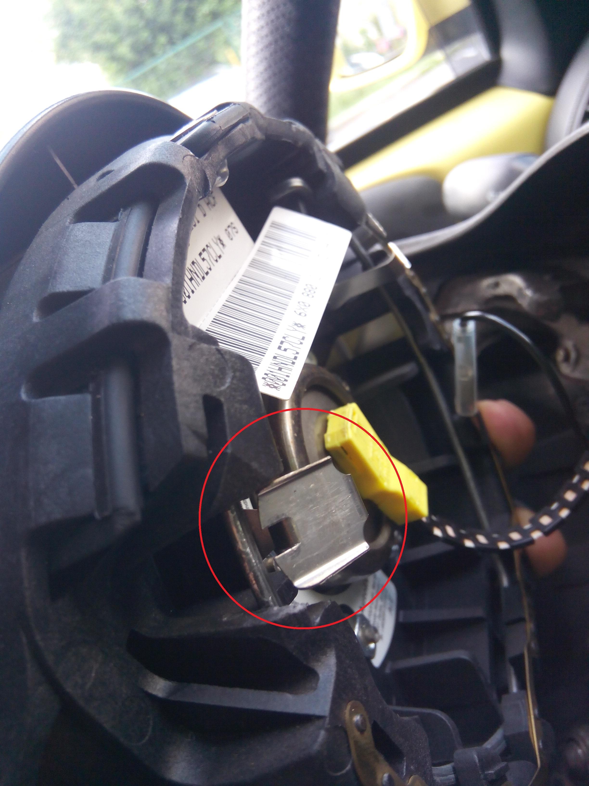

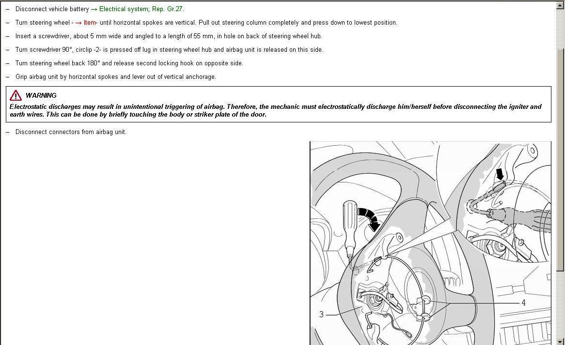

lupo 1.7sdi Posted September 12, 2025 Report Share Posted September 12, 2025 I disassembled the steering wheel twice when changing the levers. I did exactly as in the photo and it worked. A few observations from what I remember because it's been quite a while since then: - a small mirror would help - where that wire comes into contact with the airbag hook is a kind of metal clip that makes it a bit confusing to pass the wire over the hook (that clip doesn't appear in the drawing) - after the wire has released the hook you have to pull the airbag quite hard Quote Link to comment Share on other sites More sharing options...

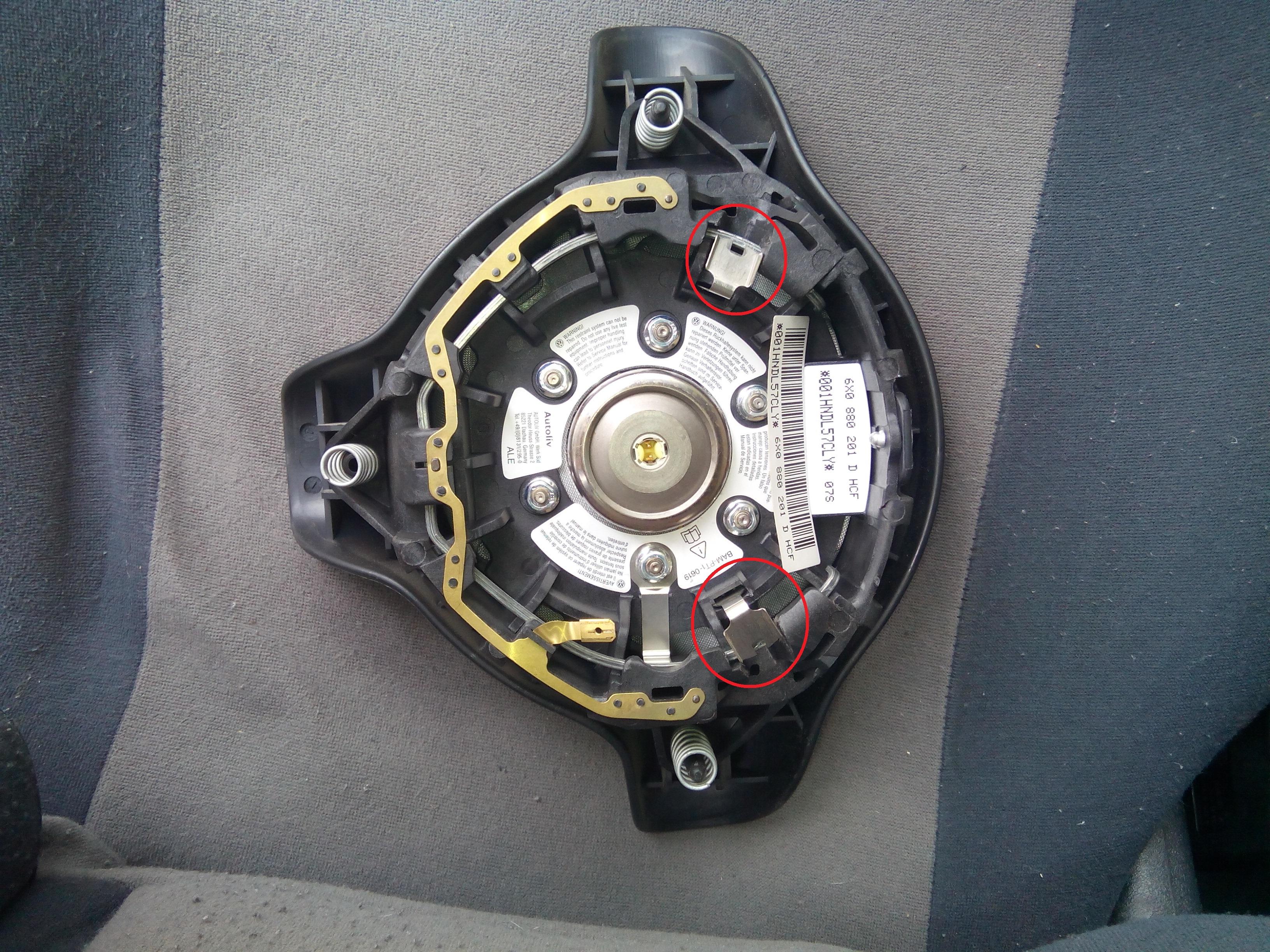

lupo 1.7sdi Posted September 12, 2025 Report Share Posted September 12, 2025 The two clamps I mentioned above Quote Link to comment Share on other sites More sharing options...
mk2 Posted September 12, 2025 Report Share Posted September 12, 2025 Here: https://forums.clublupo.co.uk/uploads/monthly_2020_04/1zegjsw.jpg.37169b93c5d5c89bc2cf2d237624bf44.jpg 1 Quote Link to comment Share on other sites More sharing options...
Adam Meader Posted September 13, 2025 Author Report Share Posted September 13, 2025 Thanks all, clips are off! Will begin removing the existing wheel later on. If I encounter anything abnormal then I'll get in touch. You two have been incredibly helpful, thank you so much! 1 Quote Link to comment Share on other sites More sharing options...

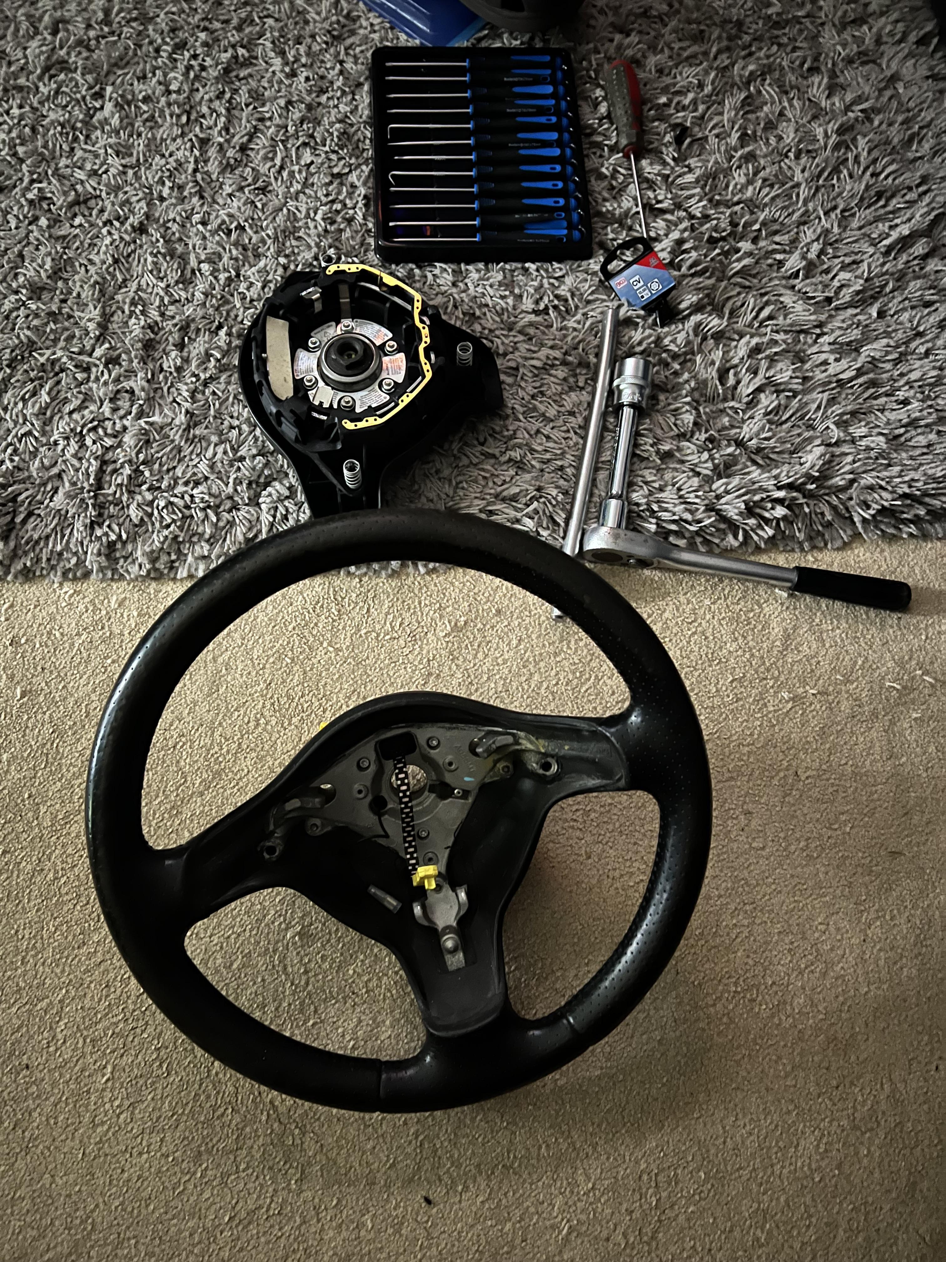

Adam Meader Posted September 13, 2025 Author Report Share Posted September 13, 2025 (edited) Right, good news is steering wheel is on, but bad news theres an airbag light and it just wont go. Error code 00588, most likely clockspring or faulty connection to the airbag. I went to steer on full lock to park up, and heard a big click, after that the light come on. Any ideas there? Do we think going back to the original may solve the problem? I've checked everywhere and nothing looks broken, still a bit worried if I've done something by accident.. Edited September 13, 2025 by Adam Meader Quote Link to comment Share on other sites More sharing options...
mk2 Posted September 13, 2025 Report Share Posted September 13, 2025 Yep. You broke the clock spring... I guess you've already looked up how it works. Internal spiral ribbon cable connection. Easy enough to find a replacement at the breakers or even new. Steering wheel off again... Quote Link to comment Share on other sites More sharing options...
