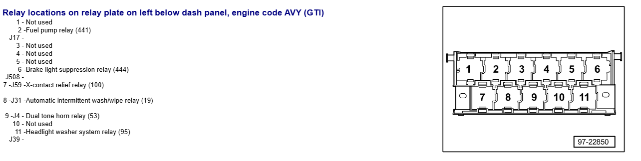

Tomandrew10 Posted June 22, 2025 Author Report Share Posted June 22, 2025 I’m thinking it’s more a power issue than a key issue, because if it was a key issue would there not be some response from the ecu to the immobiliser? I'm also struggling to find relay 109, I’m not sure if it has been replaced with a relay with a different number on it. There is a 95 which I’m not sure about all the others seem pretty normal. Do the positions of the relays vary from car to car? Thanks Quote Link to comment Share on other sites More sharing options...
mk2 Posted June 23, 2025 Report Share Posted June 23, 2025 You already have the immobiliser response code... it's the ECU that's given that code above, not the immob? Positions are the same, so you might be right. Might have been changed before? @lupogtiboy, do you have a relay position diagram? I can't find one for the Gti. 1 Quote Link to comment Share on other sites More sharing options...
Rich Posted June 23, 2025 Report Share Posted June 23, 2025 Does a GTi have 109? Location? 1 Quote Link to comment Share on other sites More sharing options...
lupogtiboy Posted June 23, 2025 Report Share Posted June 23, 2025 2 Quote Link to comment Share on other sites More sharing options...
Tomandrew10 Posted June 23, 2025 Author Report Share Posted June 23, 2025 That really helpful thanks!! I’ve seen some stuff saying p1570 is a hard code and is difficult to get rid of does anyone know anything about this? Originally there was a code about low voltage which went after the battery was charged so wondering if it just needs hard clearing. I’ve cleared the code on vcds but it just comes straight back so I’m wondering if it isn’t fully clearing it? Thanks Quote Link to comment Share on other sites More sharing options...
