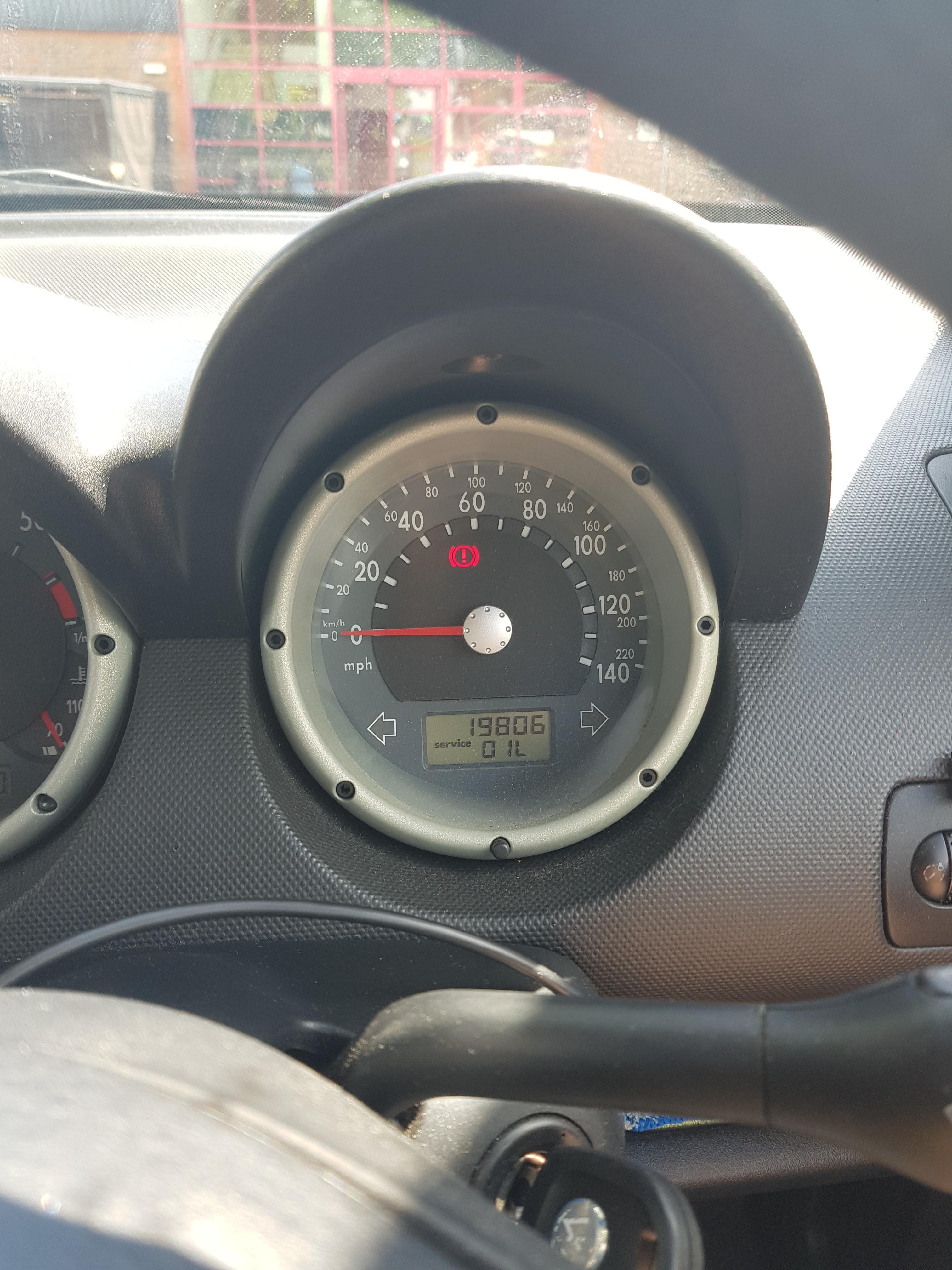

Adam Meader Posted May 30 Report Share Posted May 30 Hi all! Just wanted to see if someone would be able to assist with my query. After starting my lupo up today, I am met with an Oil Service Warning, despite changing the oil in January of this year. I think I read somewhere that these engines are to be serviced more regularly than average (I have the 1.4 16v 75hp) but this just seems a bit uncanny. Anyone had this with theirs? Is it normal? And does the oil actually need to be changed that frequently or is it just a bad sensor? I shall await your response Thanks! -Adam. Quote Link to comment Share on other sites More sharing options...
ObjectiveAway Posted May 30 Report Share Posted May 30 hold in mileage reset button, turn ignition on (don't start car) and wait for display to show ------, realease mileage reset button. Thats it. Quote Link to comment Share on other sites More sharing options...
Adam Meader Posted May 30 Author Report Share Posted May 30 4 hours ago, ObjectiveAway said: hold in mileage reset button, turn ignition on (don't start car) and wait for display to show ------, realease mileage reset button. Thats it. Thanks for this mate, but just wanted to know if there was a reason why it come on? Quote Link to comment Share on other sites More sharing options...
ObjectiveAway Posted May 30 Report Share Posted May 30 Just now, Adam Meader said: Thanks for this mate, but just wanted to know if there was a reason why it come on? They forgot to reset it. Quote Link to comment Share on other sites More sharing options...
Adam Meader Posted May 30 Author Report Share Posted May 30 1 minute ago, ObjectiveAway said: They forgot to reset it. It was reset after the January service Quote Link to comment Share on other sites More sharing options...
lupo 1.7sdi Posted May 30 Report Share Posted May 30 The only reason that warning appears is the km (miles) since the last reset. This car does not have sensors that measure oil quality/quantity or anything else that would cause that warning to appear. 1 Quote Link to comment Share on other sites More sharing options...
Adam Meader Posted May 30 Author Report Share Posted May 30 6 minutes ago, lupo 1.7sdi said: The only reason that warning appears is the km (miles) since the last reset. This car does not have sensors that measure oil quality/quantity or anything else that would cause that warning to appear. I see what you're saying I'll reset the trip and clear the warning, see how we go. Thank you both! Quote Link to comment Share on other sites More sharing options...
