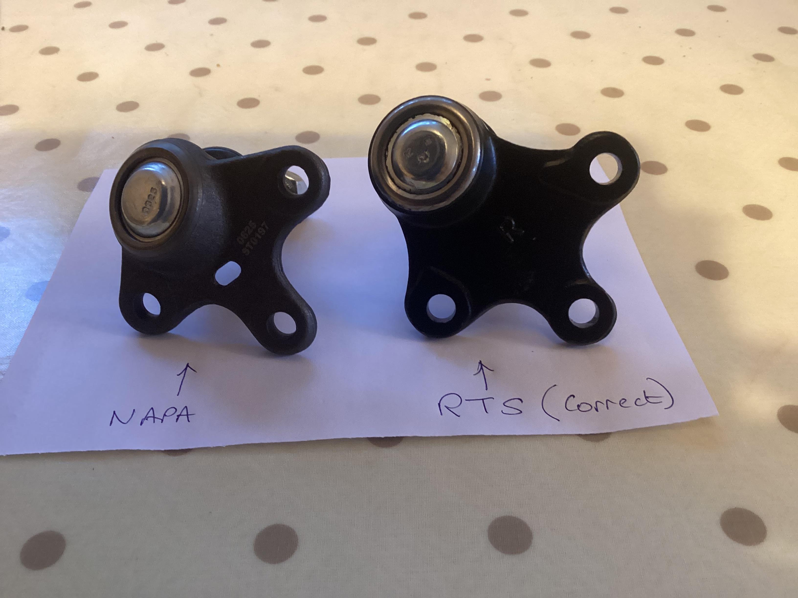

MRG Posted February 17 Report Share Posted February 17 I've bought several ball joints listed for the Gti. Returned them all but here is one from Napa shown alongside the RTS joint. Underside view shows the difference best. GTis are 10mm threaded. Underside shows the R which is the passenger side and matches my old passenger side original joint but with no slot. L on the underside is the driver side. Quote Link to comment Share on other sites More sharing options...
mk2 Posted February 17 Report Share Posted February 17 Got a pic the other way up, with the thread pointing upwards? It 'does' look like a 9N ball joint from below. I'm just thinking, I wonder if the threaded part is important- as in, the purpose is simply to pull in the cone into the hub carrier. If it uses the larger cone, my guess is that a 12mm thread will fit through the hole. Unless the cone is longer and the pointy end is smaller? Quote Link to comment Share on other sites More sharing options...
