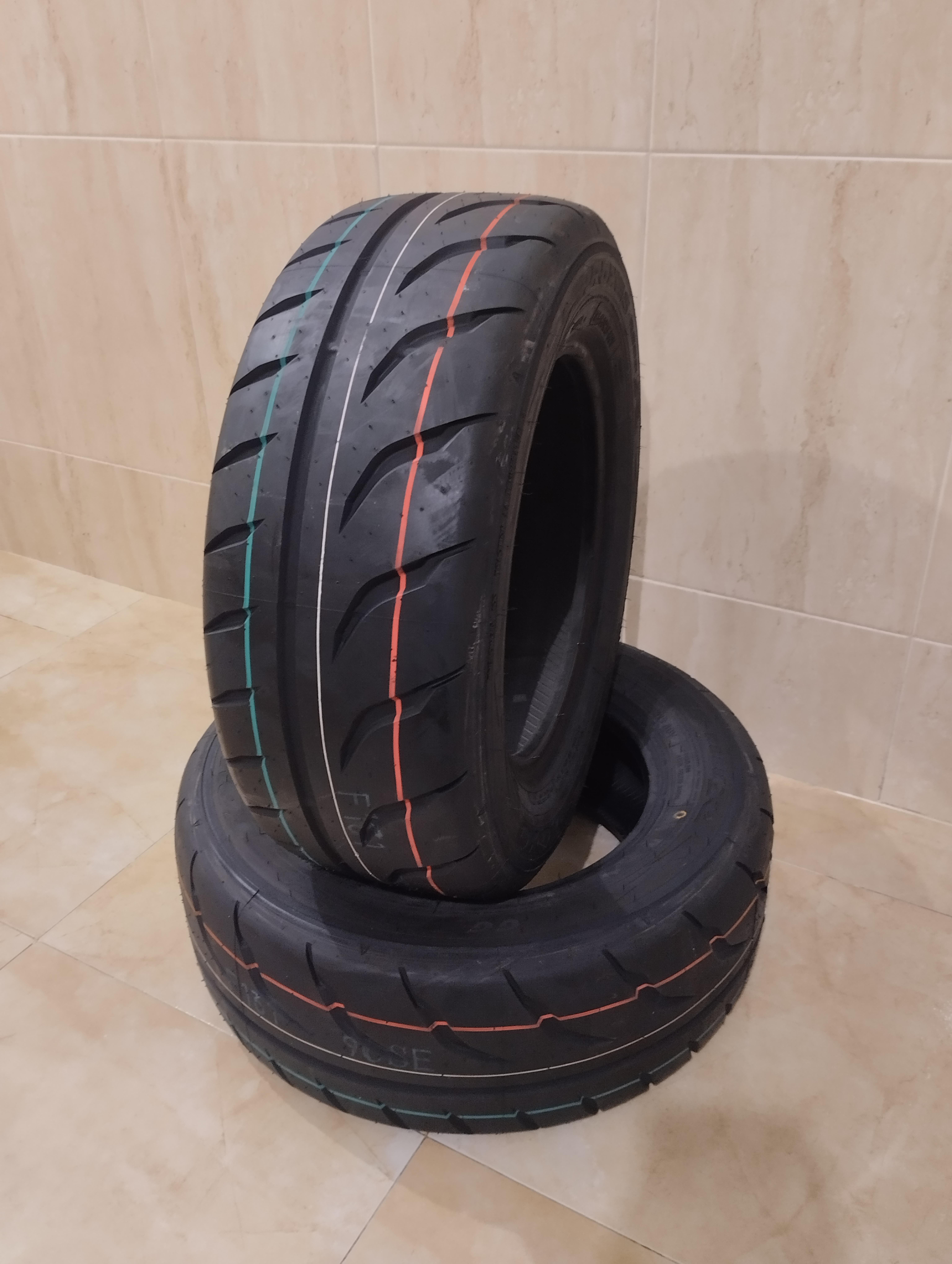

amgeriz Posted April 15, 2025 Author Report Share Posted April 15, 2025 (edited) I finished the front tyres again, this time only covered 7000km because of the camber. The problem I have is that I can't wear them quick enough on the outside to compensate inside wear on normal use, plus the inner tyre spins on hard cornering, worsening wear even more. I already decided what tyres will be the replacement, to suit better my needs But before, because I have still some tread on the rears, better than buy another pair of Nankang, I'm going to try these Toyo R888R to compare. Edited April 16, 2025 by amgeriz Quote Link to comment Share on other sites More sharing options...

amgeriz Posted April 15, 2025 Author Report Share Posted April 15, 2025 (edited) Not much... The Nankang NS-2R today cost 81€, the Toyo R888R 110€ and my next choice, the Yokohama A052, 116€. Edited April 15, 2025 by amgeriz 1 Quote Link to comment Share on other sites More sharing options...

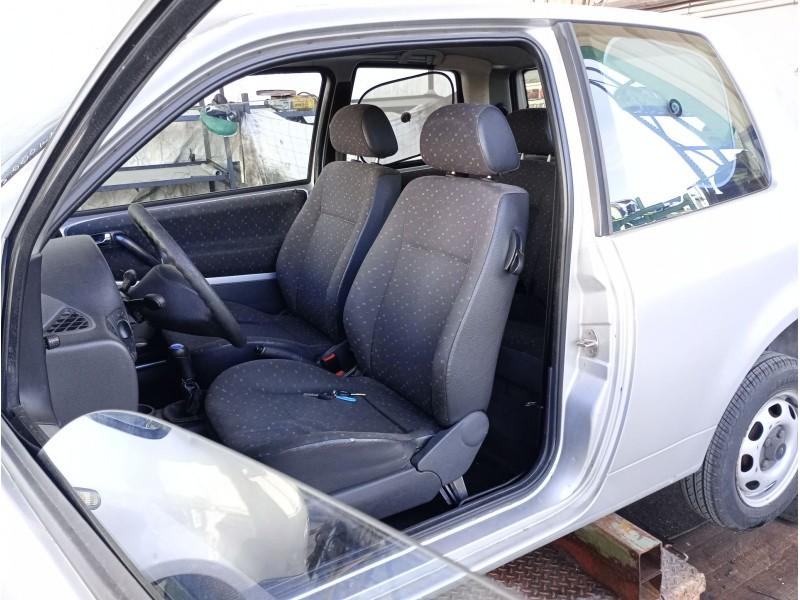

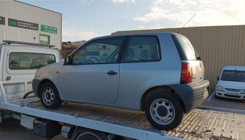

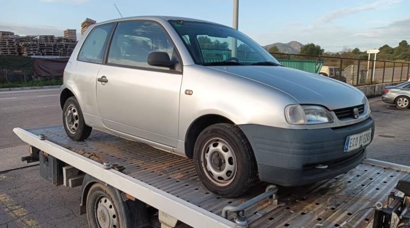

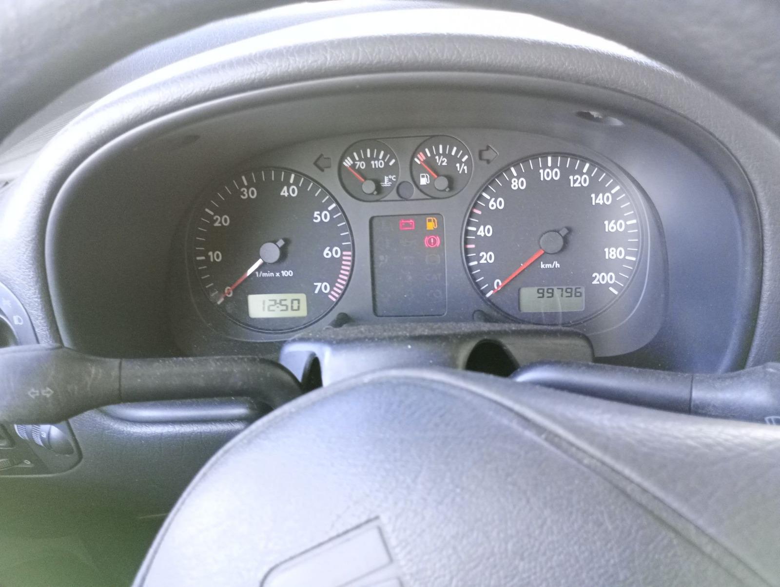

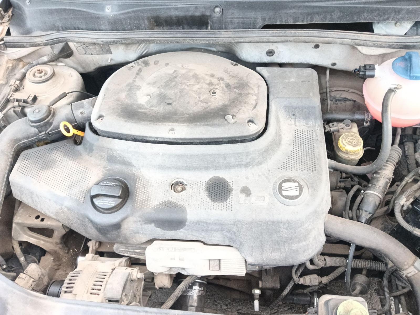

amgeriz Posted July 26, 2025 Author Report Share Posted July 26, 2025 (edited) Big update. I didn't use much the car since the new tyres, because I found that was I tought initially was a coolant leak, in reality was a blown head gasket. The only signs were white sludge on the oil cap and coolant consumption, but both oil and coolant looked fine all the time. So with this problem, a noisy elongated timing chain and +250.000 km I decided to swap to another engine. The donor car was a low mileage seat arosa mk1, that honestly was in really good shape to end in the junkyard. But in the end was a good deal for me. Edited July 26, 2025 by amgeriz Quote Link to comment Share on other sites More sharing options...
mk2 Posted July 26, 2025 Report Share Posted July 26, 2025 Wait. What?! You bought a perfectly good Arosa from a scrap yard to use as a parts donor car?! What is wrong with people, scrapping good cars?! Quote Link to comment Share on other sites More sharing options...
